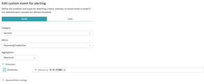

I have configured this alarm end-to-end and gotten an alert to successfully fire under the condition I configure the alert using the 'build' option (filtering by only a single dimension value):

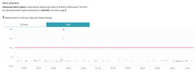

When I try to create a very similar alert using the 'code' option (because I need to filter on multiple values for the dimension, which doesn't seem possible using the 'build' option), I get a preview that indicates alerts should fire, but they never actually fire:

  • I used the 'build' option for one and the 'code' option for the other.

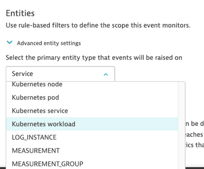

  • For the alert that uses the 'build' option, I am able to set entity scopes for the alert (such as management zone).
  • For the alert that uses the 'code' option, I am unable to set these entity scopes (i.e. I can't select management zone from the dropdown).
My leading theory is that the issue lies with the fact that the code-based alert does not have a management zone entity set (it doesn't seem to let me set one). As a result, the alert doesn't match the management zone for my alerting profile, and therefore I don't get an alert.

I still don't fully understand which conditions cause a custom alert to be associated with a management zone (such that it is 'respected' by an alerting profile that has a management zone condition set). My best guess is that you must have a management zone entity filter applied in the custom alert configuration. I still don't understand how this is possible when the custom alert uses a code-based metric expression (as you seem to lose the ability to set a management zone entity filter this way).
