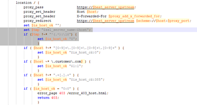

By adding the following IF statement to the nginx.conf file on each cluster node for below locations, I was able to address the problem
  • location /api/
  • location ~* /e/[^/]+/api/
  • location /
Added below IF statement just before last IF statement where it evaluates the $is_host_ok validity
if ( $host ~* \.customer\.com$ ) ) {
       set $is_host_ok "$1:1";
This adjustment allowed me to seamlessly access the Dynatrace Web UI using the FQDN of the load balancer. However, I’d appreciate your insights on whether this approach aligns with best practices or if there’s a more optimal solution.

HI @Yosi_Neuman ,
Yes, we have the same setup as you mentioned like cluster node own IP address configured on each nodes WEB UI IP section and Custom SSL certificate is installed on each node.
Currently, we are using DNS based load balancing where my existing FQDN (Configured in Public endpoint section) resolves to all 3 cluster node IP address. However, customer is now asking to have a F5 load balancer instead of DNS load balancing. We have configured the F5 LB with cluster nodes as backend on 443 port but when we are accessing the Dynatrace using LB FQDN it is redirecting to Dynatrace Error page SSI: not_set (refer to attached image in main post) but same working fine when accessed with LB VIP IP.
While I checked the Nginx configuration file of cluster node I found that there is a condition where it checks if the SSL_Server_Name is equal to the Hostname (if not redirects to HTTP 403 page)
(Condition highlighted in below snapshot)
hence I made the mentioned changes (3rd IF statement in above snapshot) in the config file to bypass this condition since "ssl_server_name" is coming null from F5 in my case. I have also raised this with F5 team to check on SNI settings at there end.
After adding the mentioned IF statement I am now able to access Dynatrace using LB FQDN but I agree that making changes in the config file is not correct hence waiting for F5 team to check at their end and update.

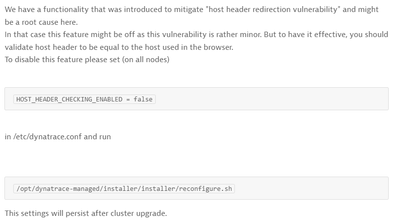

Hi @Yosi_Neuman
As I suspected and mentioned earlier, Dynatrace support has confirmed that the functionality/conditions written in Nginx configuration to check the host name is causing this issue.
Resolution
1) Work with LB team and check why the FQDN and Host HTTP header value are not same when the requests are coming from F5 load balancer to cluster node (SNI needs to be enabled at LB end)
2) Disable the Host header check (below is the support response)
We have disabled the Host Header check and issue got resolved
