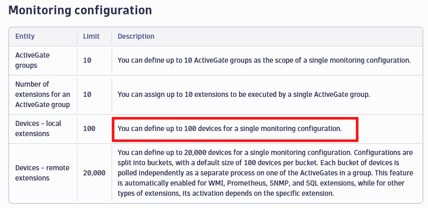

@mferstl,
Yes, there is a limit of 100 per monitoring configuration:
https://docs.dynatrace.com/docs/extend-dynatrace/extensions20/extensions-concepts
Antonio Sousa
SNMP extensions are remote, and fall under the next row in that table. The limit is 20.000. I'd go with a support ticket if it's failing.
