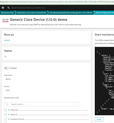

You can find the monitoring configuration by entering that GUID into the URL of the extension. Here's an example:
