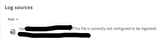

In a host screen, we can see logs that have been detected but are not ingested:
How can these be listed via an API call?

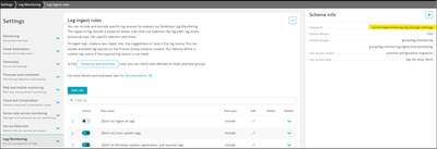

Logs are discovered automatically but if you want to ingest then, you need to create logs ingestion rules.
It means, you can check your rules in tenant, host groups or host to know.
It can be checked from API.
Best regards

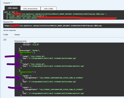

Hi @benjamin_johnso
Check the response of /api/v2/entities/{entity-id} with process instance id and look  for logFileStatus or logSourceState values. If its not appears try to extend the api timeframe.
HTH
