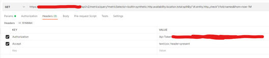

Hey Balamurugesh,
If you request the data in CSV format you will get get a date/time format as seen in my screenshot below.
My example query looks like the following.
The docs for querying metrics can be found below with an example for the CSV format at the bottom.
https://www.dynatrace.com/support/help/dynatrace-api/environment-api/metric-v2/get-data-points#tabgr...
Unfortunately I can't see a way to request the time in a date/time format when getting a response in json.
13 Jul 2022 03:56 PM
thanks for the details. When i query metrics API, am getting monitor Id's in response. Is there a way to get monitorName instead of monitorId in response?
13 Jul 2022 11:38 PM
If you have a look at the screenshots I posted you can get the name by adding :names to your metric query. As you can see in the CSV response for my query the name of my http monitor is Recipe API.

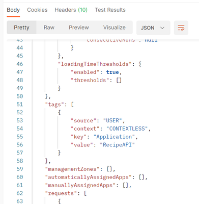

22 Jul 2022 02:19 PM
hi Fin, I have tied each synthetic monitor with respective application. Am looking for application name as well in response. Is there a way to get the tied Application name in response?
Regards,Dingu
25 Jul 2022 01:08 AM
If you tied the application name to the synthetic with tags, as far as I can tell that isn't possible without making another request to get the details on the synthetic in question. Using the returned synthetic ID you can query the synthetic API to get all details including tags.
https://www.dynatrace.com/support/help/dynatrace-api/environment-api/synthetic/synthetic-monitors/ge...
Below is an example
25 Jul 2022 06:01 PM
Is there any possibility to get the application details in metrics API call?
26 Jul 2022 08:13 AM
Not that I can find unfortunately unless you used a synthetic naming scheme that used the applications name since the synthetic name is provided in the query response.
